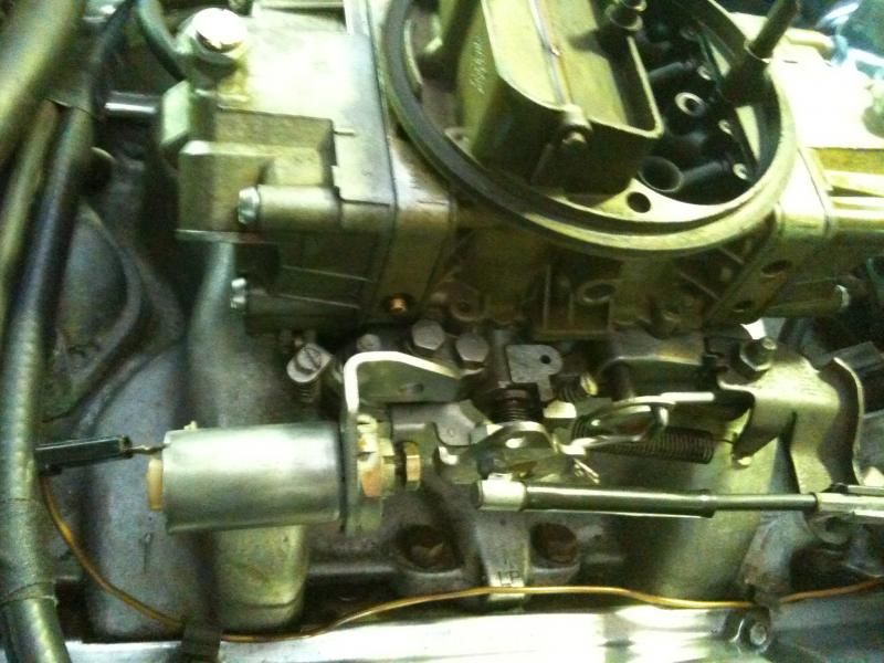

    Originally posted by Wayne Perreault (9383)
    Here are a few pictures I took at KC to help out a friend who bought my 72 LT1 w a/c in 1985. It looks like your are missing the same solenoid as my friend. I have more pictures on another camera that I have not looked at yet. If you can contact me, I can put you in touch with the two owners. I can post more pictures or send you what I have. Also inside of my friends Holley is black like yours.
    [ATTACH=CONFIG]54225[/ATTACH][ATTACH=CONFIG]54226[/ATTACH]
    That looks like a TCS solenoid.
    • Michael W.
      • April 1, 1997
      • 4290

        Roy here a few quick pictures taken in the garage. photo 3.jpgphoto 1-2.jpgphoto 2-2.jpg

          Patrick and Michael from the helpful posts and my reading you are both are right. It is a set idle and anti-dieseling solenoid. Yes, it is unique to the 72 LT-1 year. This weekend I plan to double check the dwell, timing and then adjust to the higher idle rpm (900 rpm). This is higher than I prefer but seems no escaping that as stock configuration for the engine to handle the a/c as there no a/c activated idle step up.

              Re: 72 LT-1 with A/C - rpm drops signifcantly with the a/c compressor on
              I said it was both, he just said it was an anti-diesel solenoid. There is a difference - which is why I pointed it out. To call it "just" an anti-dieseling solenoid is to miss its most important function on a 1972 Corvette.
              The solenoids function the same for all 1972 Corvettes; just the bracketry holding it to the carburetor differs between a Holley carb and a Quadrajet carb. In fact, the solenoid portion of it is exactly the same.
              And you are correct in that each year used solenoids attached to the carburetor in a different fashion.
              Anyway, good luck on getting the tuning right. It's not that difficult once you understand how it's supposed to be done.
                Wayne,
                your photo seems to show a pre 1972 TCS switch with a gas line bracket. The bracket and switch should be one piece (part number is not available to me but should be in the AIM). There is excellent information on CEC/TCS systems in the archives posted by Jack Humphrey. Researching that will answer all the questions.
                • Wayne P.
                  Infrequent User
                  • June 14, 2012
                  • 25
                  #23
                  Thanks Dave, I did find an article, that is Jack wrote for the Driveline dated 20 February 2005 and was posted in the Rocky Mountain Chapter newsletter in 2006. 71 was a one year only and the article states that the 72 had a TCS solenoid added. I will do more research. I wil forward the article on to my friends.

                      #25
                      Congratulations Ed,
                      Here is a couple pictures to help.
                      I can't remember the RPM drop when turning the AC on, with my 72 but I can start it up perhaps later today and test it for a comparison?

                              #29
                              I want to weigh in on the discussion as I have the 1972 LT-1 AC car which Wayne was speaking about. Although I aced my ops check at the 2014 National convention in KC, I had to contend with the same problem as Ed, and had to get everything fully tuned and humming properly before my AC would run at idle without stalling the engine. Of course you have to make sure the AC compressor is working properly, too. Even with all that, and a 900 rpm curb idle, the AC will still drag the engine down 1-200 RPM. It runs fine at that speed, however. There is no "kickup" solenoid on a 1972 LT-1, but there is a TCS solenoid on the RH side and an anti-diesel solenoid on the carb on the LH side, as has been explained. Often the smog and TCS solenoid were removed on these cars by a past owner and the wires clipped off.
                              I hope this helps, but Ed, feel free to write me directly if you have any more questions and I'll try my best to answer them.
