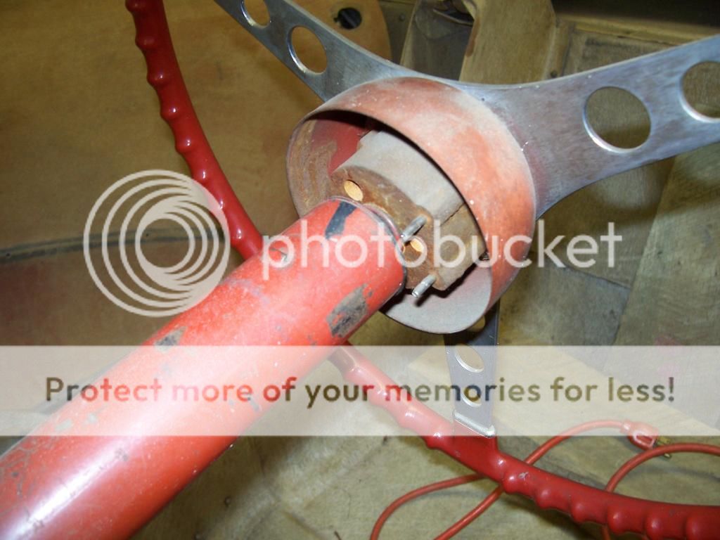

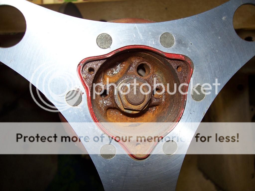

                    I popped the horn button off, remove 3 screws that hold cup to wheel and took a look, all with car wheels straight ahead.
                    Findings:
                    1. emblems on horn button point to right 3 o'clock.
                    2. chisel mark on shaft points to 3-4 o'clock.
                    3. hole for spring loaded horn contact is further around clockwise at about 5 o'clock.
                    4, third member straight ahead, not detectably bent. Tie rods equally adjusted.
                    Will try to send photos of all this but having some trouble getting them to send.
                    To me, seems like wheel and its hub are on shaft correctly but problem down stream-drag link out of adjustment or somebody did something strange in past, but what do you think? Hope this info makes things easier to sort out.
                    Thanks.

                      #25
                      Re: '62 steering wheel alignment
                      These are photos of wheel, shaft, 3rd member, tie rods.- didn't send pic of tie rods but hope this doesn't matter
                        Okay, Those look like original rivets holding the wheel to the hub.
                        Your 3rd arm picture is really the "3rd arm bracket", which bolts to the frame. The arm that may be suspect of being bent, is that part that looks like a arm coming off the big bearing end and connecting to the drag link.(background in the pic, but only showing part of it)
                        I just thought of something......... From center, a C1 steering box turns 2 1/4 turns(apx) to either side of center. With the Pitman Arm removed from the drag link, set the wheel with the notch pointing up, then turn it in both directions counting the number of turns. What do you get?
                        If = 2 1/4 turns each way, your shaft and worm and sector shaft is correctly aligned. Problem must be down below related to the drag link or 3rd arm or other steering piece(s).
                        If it's off by 1/4+ turn(like the way it's off 90*+ in your pic), I suspect someone played with the shaft & worm spline alignment. But I haven't had a worm off in many years so I'm not sure if there's a flat spot for alignment or not. I have a worm/shaft out of a car I'll take a look when I get a chance.
