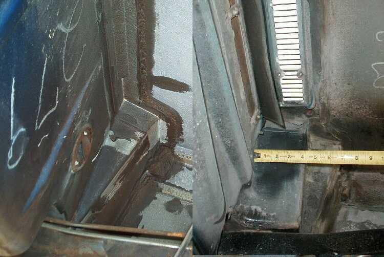

              If you want to see what I am talking about, look at this pic: On the left is Juliet's 70, on the right is my 73. Front of car is to the left. This is under the rear deck looking up at the passanger side in the vent/rear bulkhead area. You can easly see the 4" setback.

                  My '71 conv. measures 26". Is it possible that there is a difference in A/C vs non A/C cars? The rear vents are part of the Astro ventelation on non A/C cars. Just a thought.

                    I think the only difference between the A/C and non-A/C cars is if the vents are functional or non-functional. Juliet's car is a/c, but it has the deep luggage compartment. The vents are over the compartment and have the drains to the rear, but does not have the functional astro vent system. My '73 is A/C and it has the short luggage compartment. You can see where the astro vent system would be mounted if they were operational. So the depth of the luggage compartment doesn't appear to have anything to do with if it is A/C or not.
                    So we have:
                    1970 = 30"
                    1971 - 1973 = 26"
                    I would assume then that 70 and earlier are all 30" deep luggage compartments and '71 and later are all 26". Interesting, I would have thought that if it was done for crash protection the change would have occured in '73 or '73 with the new bumper standards. But apparently it occured in '71.

                            1. I would like to expand on Terry McManmon's comments regarding the treatment of the rear deck vents on 1968-1973 Corvettes. One set of design facts apply to 1968-1970 cars and another set of design facts apply to 1971-1973 cars. It is a somewhat complicated situation and I apologize if I get too detailed.
                            2. On all 1968-1973 Coupes, the rear deck vents are over the interior cargo area and there is a hard fiberglass plenum below the vents to catch outside water and dispose of it so it does not get inside the car. When you look down the rear deck vents from the outside, you don't see anything except that plenum and this is true for both cars with C60 AC and for ones without C60 AC. As was previously pointed out, cars with C60 AC do not have the Flow Thru Ventillation flapper doors installed on the plenum, instead, fixed block off plates are permanently bonded in place.
                            3. On 1968-1970 Convertibles, the rear deck vents are also over the interior cargo area and there is also a hard fiberglass plenum below the vents to carry of water so it does not get inside the car. Again, when you look down the rear deck vents from the outside, all you can see is that plenum. On non C60 AC Convertibles, the Flow Through Ventillation flapper doors were mounted to that plenum from the inside of the car. For Convertibles with C60 AC, block off plates were bonded to the plenum.
                            4. Starting with all Model Year 1971 cars, a design change was made to shorten the rear cargo area by three inches. Therefore, on 1971-1973 Convertibles, those rear deck vents are now just aft of the rear cargo area bulkhead and keeping water out of the cargo area was no longer an issue. For 1971-1973 Convertibles WITH C60 AC, there was nothing below those rear deck vents and you can see the ground when looking down the vents from the outside. On 1971-1973 Convertibles WITHOUT C60 AC there is a soft rubber boot installed below those vents across the entire rear deck; this boot has a round drain hole on each end to let water drain to the ground. Finally, on 1971-1973 Convertibles, the flapper doors for the Flow Through Ventillation are mounted directly to the vertical aft bulkhead on cars without C60 AC. On cars with C60 AC, fixed block off plates are bonded on the bulkhead.
