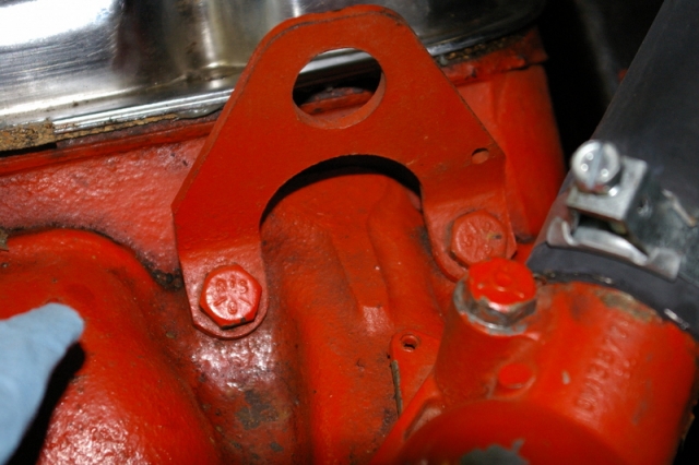

        Re: C# BB Manifold Bolts & Lift Brackets
        Sheldon,
        Pic of my 71 LS5. The bolts for the lift bracket are not shouldered. I believe this configuration to be original.
        Tom
