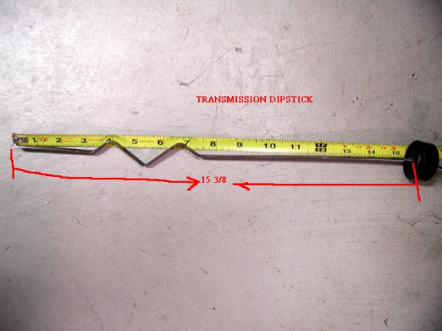

    I have 4 1/2 quarts in the trans and can NOT get a reading on the stick.
    Picture attached............

          Picture please Roy
          I have a dip stick pictured like the one in the post. I am told it is the wrong one for a 55. I now do not know what to look for. If you have a picture showing the handle as well i would appreciate seeing it. Thanks in advance

            9 quarts is correct and the stick is correct, yes some people think the 53 to 54 Corvette is correct (same as early 6 banger Car )but 55 up Corvette and Car V8 are the same stick in most cases till the cast iron PG was dropped. 53-54 has a different reading . Don't think it's mentioned in the JM. As many things ant.
            (by the way running about 1 quart low will not hurt the trans and stop the leaking and throw ups )

                I'm hoping the reason it is NOT engaging is because I don't have enough fluid. I sure hope you guys are correct about the 10 quarts. This trans was completely rebuilt before I installed it.
                I will take a picture of the dip-stick and posted.
                Thanks again.........I will keep you guys posted of my results. Right now I have to address the leaking and check linkage.
