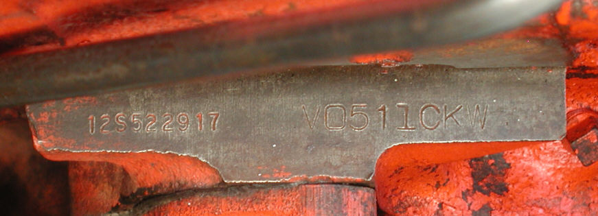

    Could someone please give me a crash course on broach marks. What they are, Where they are, and how they should appear on an unaltered pad. Thanks.

    What - Longitudinal machining lines on the engine's stamp pad.
    Why - When the block was decked at the factory, the blades left these lines. If you've ever scraped items with a razor blade you've noted that the blade gets nicked over time. In a similar manner, worn blades caused deeper "broach marks" on some pads.
    How - can appear from "invisible except with magnification" to rather deep. My originals are shown below. See enough examples and you'll begin to tell apart real from fakes with reasonable certainty.

        Re: Broach marks
        Gentlemen,
        That was the most complete and thorough explanation I could have hoped for. Thank you. Patrick, your photo was awsome. Markings were distinguishable. Thank you guys, as always.
