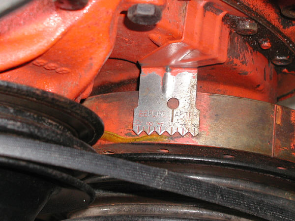

    Can anyone tell me what the correct finish on a small block timing tab should be? TM/JG suggests that the portion of the tab w/adjustments is unpainted, but that there are "a few original cars that have been found where this detail is omitted." Should the entire tab be unpainted? Thanks in advance.

      Unpainted.
      Or, likely more accurate, painted and wiped off. You can see the numbers have some orange, especially those on the left.

        Thanks guys. Patrick's pic is certainly worth a thousand words!
