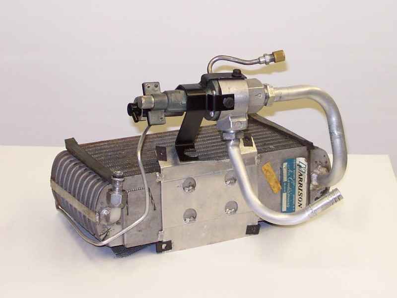

          • Pat #25912
            Re: 66 A/C help
            Robert, the pic below shows the STV you will need. I believe they fit '64,'65, and '66, but not '67. They are not reproduced and won't be cheap. I have more pics plus some older film pics of the housing that I could scan if you want.

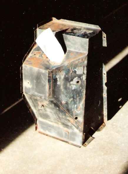

                • Pat #25912
                  Re: 66 A/C help
                  Robert, I believe the box and core are the same ('66 and '67) but the valves and thingies are different.
                  You might try looking in the LIC catalogue and see what parts are listed for the different years. It might help to have the AIM for '66 and '67. I could send a page from the '66 if you don't have.
                  The pic is the evap core box. I have more pics I could send you direct instead of taking up space here. Send me your email address if you want them.
