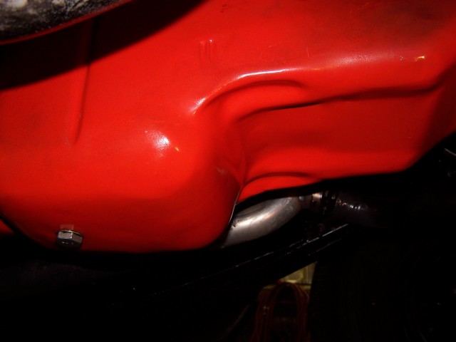

                        Below is a photo of my '59's oil pan....which is comparable to M. Greene's description......I've been told it is correct. The car received the Triple Crown at Chicago last November.

                          Re: 1957 oil pan (Joe) No just prints
                          that pan pictured is passenger car pan. probably from a 57 chevy. i see alot of 57 corvettes with that pan. you cant get better than tripple crown so i would not worry about it. however; the 58 up pans that would be correct for your car are not hard to come by and not much money.
