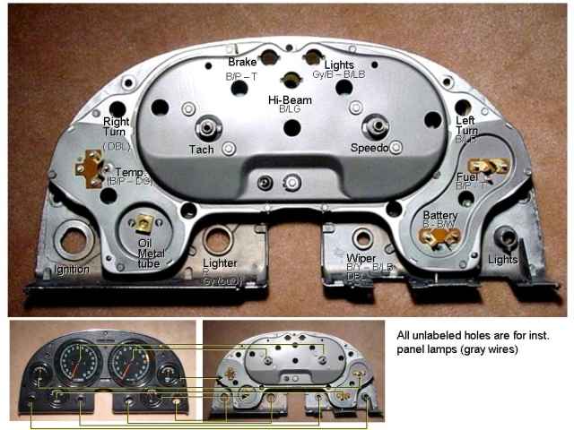

    I removed my 67 dash cluster last week to get it reconditioned. I noticed an 1816 bulb socket that was empty and just hanging behind the cluster when I removed it. I assumed at the time that one of the gauge lights had fallen off. However, as I count the number of holes in the back of the dash and the number of light sockets hanging in the car, I seem to have 1 too many light sockets. Is there always an extra 1816 light socket in the 1967 dash cluster wiring? Maybe for some option that I don't have? Maybe I just need to count better?? Thanks.

    Although I don't have a 67, I'm not aware of any "spare" or "optional" sockets that should be found. There is a socket/lamp that back lights the ignition switch, that on my car when purchased had a burnt-out bulb in it and was just dangling behind the cluster--could this be the socket you've found?

            There are two lights that don't go in the holes in the "can" on the back of the cluster; one in the ignition switch housing, and one that clips on the outside of the lighter housing. Are both of those installed?

              I have a sneaking suspicion that it must have been one of those that the previous owner didn't have installed. It was just haging down on the left-hand side (facing dash - window wiper switch area) without any bulb even inserted into it. So, once the dash was out I counted the 1816 "bulbs" and then counted the 1816 holes in the back of the dash cluster and seemed to have one extra bulb. From what you are stating however it seems that I should actually have two extra 1816 bulbs for the ignition switch and the lighter housing. I know that there wasn't one on the lighter housing as I unscrewed it and removed it before the cluster was even out of the car. So maybe, it is for that. What does the clip to the lighter housing look like? Can I get one from a current supplier? Thanks.

                    From the sketch I did when I did my 67 cluster, I think there are 11 illumination bulb sockets with gray wires. 7 of these come from the right (passenger) side of the harness, and 4 come from the left (driver) side of the harness. The ignition light and cigar lighter light come from the right (passenger) side. The lighter shade housing just clips into the two slots in the lighter housing.
                    If you found a socket dangling in the vicinity of the wiper switch, it is probably for the socket hole in the cluster just above the wiper switch. That one comes off the left side of the harness.
                    Maybe someone rearranged the sockets in the holes (or maybe I'm all balled up with my left and rights But when you go to set that last bulb socket, in a contorted position, and it won't reach, you know you have the wrong socket in the wrong hole. Been there
                    Great photo above looking at the back of the cluster. Right is left in the photo from my directions above.

                      I've got the lighter bulb figured out now. Now, where exactly does the ignition switch bulb go?? Thanks.
                      • Kirk McHugh
                        Re: 1967 Dash Cluster 1816 Bulb Question
                        Never mind. Just looked at the Assembly Manual UPC6/B4 and see that the bulb would still be mounted on the switch assembly hanging in the car. Will check it out when the weather gets a bit warmer here in Ohio.

                            By the looks of the picture, it would appear that it would have to be.
