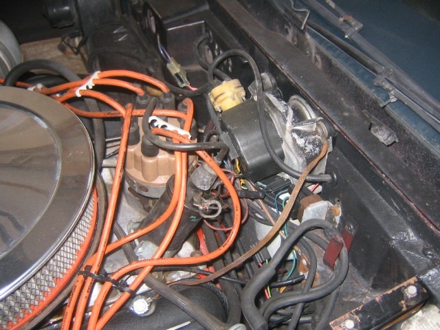

                  What I looking for is information on the 2 additional braided copper ground straps that are approximately 13 1/4 inches long that were found on my LS5. The one copper strap was found connected to a valve cover bolt and was terminated at the wiper motor bolt. I'm not sure if that is the proper placement of the ground strap since the wiper motor appears to be hung in place with rubber insulated bushings. I'm not sure the strap would serve a purpose given the wiper motor is insulated from the terminal and ground strap.
                  • Matt Callander
                    Re: I Knew I Knew Less About Big Blocks...
                    Here is a picture of the ground strap. Notice that when I received the car as a restoration project, the copper braided ground strap was connected from the valve cover to the wiper motor. What a mess!
                      Matt I am the original owner of a 68 and 70 SB's and have not seen the ground strap connected from the wiper motor to the engine like in your picture. The wiper motor from what I can tell in the service manual has a ground wire that connects to the heater motor housing for a ground. Also in looking at my 70 owners manual it shows a different torque numbers for the LS7 and also different HP. The March 1970 publication of the supplement Service News has 490 for torque and my owners manual has 500 for both the 390HP and 465HP 454's. Should of looked at the owners manual before I posted earlier about this. It looks to me that you have a distributor without a vacuum advance in your 70. Are you going to drive it for pleasure or race it?
