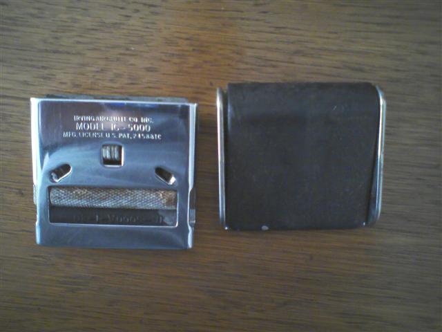

      I attached a pic of the part.
      Also, If anybody can tell me, if the (2) buckles are both correct for early (dec 62 build cars.) I can't make out the smaller "Irving" stamping. Maybe, if I sandblast it a little, I will be able to read it...

          Hello Rainer; I do believe we have talked about the restoration of 63 seat belts which I do. I take the webbing bars out by milling one end until the bar can come out. I then TIG weld the end to replace the metal I milled off. i then Grind the welds to make the webbing bar look like it should and I make sure the overall length is on the money or else you will not be able to get the bar back in! The buckels you have are NOT correct for an Early 63 corvette. The one on the left is correct for a Mid 62 corvette because it's a CS-5000 buckle. The one on the right is a LATE 63 being a large IC-5000 buckle. You need the small IC-5000 buckles to be correct for your car. You do not wnat the IRVIN small IC-5000 buckles as these are Late 62. You want the IRVING small IC-5000 buckles and the 51-198A labels and early stitch pattern. Call me if you have any futher questions and i will be glad to help you. Thanks, Andy Cannizzo-732-583-5378

              "Knurled sliding shaft"...you meant the belt tension roller!!!!
              It's simple, they're held captive by interference fit. You need to improvise a tool to 'spread' the sides of the buckle housing and then 'flip' the tension roller at a roughly 45-degree angle (one end toward the rear of the housing, the other end toward the front of the housing) and it'll simply drop out of the retaining slots.
              One way to improvise a tool is to clamp one side of the buckle housing in a padded vice while you bend/spred the opposite side with a pair of padded pliers/channel locks taking your time to SLOWLY spread the opposite sides of the housing.
              On plating, two comments:
              (1) The tension roller was zinc/cad plated to retain sharp tips and bite the belt fabric. It's NOT polished chrome...
              (2) Pick your plater with caution for re-chroming the buckle housing. MANY wind up polishing out all or most all of the embossed ID marks when they re-chrome and that'll cost you originality points since the judges want to read the emboss on the buckle!
