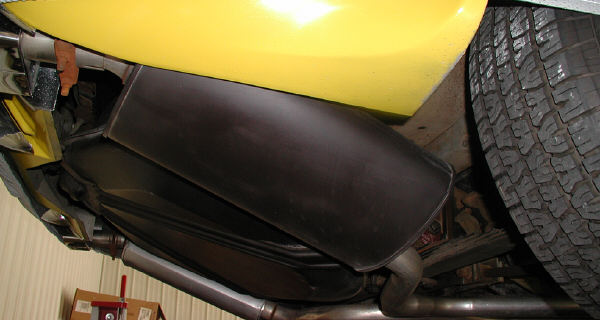

      Re: Black Out pic
      My interpretation:

        Re: Black Out pic
        Looking at the picture, I see an unpainted portion of the muffler on the far side. I assume that same muffler is painted, but on the bottom only?
        Is this correct?
          • 11643
          Re: Black Out pic
          Bottom and outer side.

            Re: Black Out pic
            No offense Patrick, but they are too smooth and too nicely done. That said, it is better than no black out.

                    Re: Black Out pic
                    Just curious when this black-out was applied, before body drop or after?
                      • 11643
                      Re: Black Out pic
                      Yeah, well, I did them installed on the car so had to be careful not to hit anything else. I made a nice cardboard backing that went all the way around and kept the paint ONLY on the muffler.
                      To do it right, and for the "next" time I do it, I'd likely hit it a lot harder, make it run, and extend it up the pipe towards the transmission. The few low mile original systems I've seen tend to support more coverage -especially up the pipe - than what I did.
                      Flight judges whacked me for the aluminized system anyway, and didn't care about the paint. Maybe next time if I overpaint they won't be able to tell.
                      Patrick
                        • 15601
                        Re: Black Out pic
                        Based on the runs on the originals I have seen it was applied when the exhaust system was upside down -- so to answer your question definitely before body drop. That said, we occasionally see a little bit of over spray from this operation on the spare tire carrier -- maybe from touch-up. It is hard to tell for sure because the evidence is contradictory.

                          Re: Black Out pic
                          So was the blackout maybe performed before the exhaust was installed onto the chassis?
                          To me it would seem logical to install the engine and trans before the exhaust but that wouldn't be with the chassis still upside down so it looks to me as though the mufflers were blacked out BEFORE installation...upside down on a rack someplace.
                          The overspray on the tire carriers might have then been from "final assembly" or "trim" workers noticing some shiney spots down there and giving the mufflers a quick shot that was missed on the initial blackout. What do you think???

                            "That said, we occasionally see a little bit of over spray from this operation on the spare tire carrier -- maybe from touch-up."
                            Would you mind sharing that with more chassis judges? I've been hit on the 72 every time it's been judged, and though I've not owned it since new I'd bet $1000 that the black paint on the spare tire carrier of my car is original. It had so much touch up done to it that I would have been surprised if they missed the carrier. If I were to ever remove the black paint (which I won't) I suspect there is yellow under it.

                              Re: Black Out pic
                              The paint I was referring to is definately unintended over spray from muffler coating. That is very different than an attempt to cover body color on the spare tire carrier.
