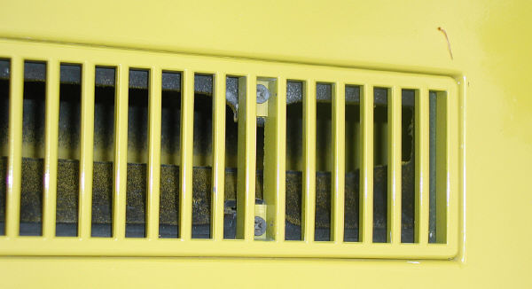

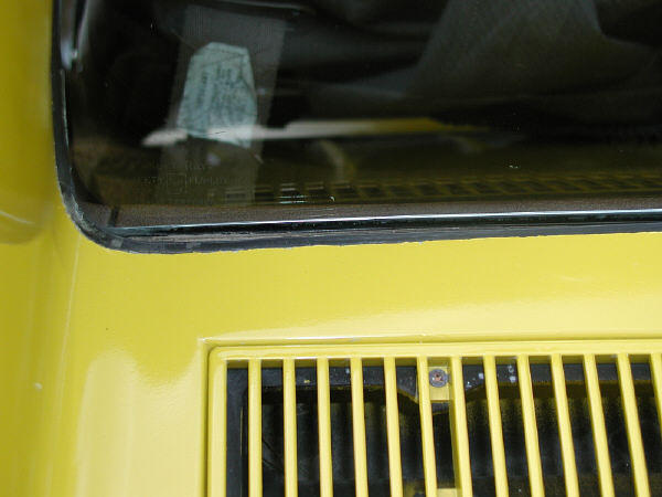

        • 11644
        Re: C3 Rear Deck Grille Painting
        Craig,
        These should help you:
        Paint the whole car white, then blackout the area under where your grilles are going to go.
        Patrick

          • Harmon C.
            • August 31, 1994
            • 3228
            Craig
            I would say that some of the blackout may have came off over the years in Patrick's posted picures or it is on the light end on blackout. I have seen better coverage on some original cars so I think you should try to look at some more examples.

                • 11644
                My car also received a fair amount of "repair line" yellow touch up at St. Louis, so it would not surprise me if yellow is on black is on yellow. Original variation, if you will.
                Patrick
