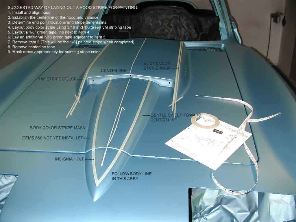

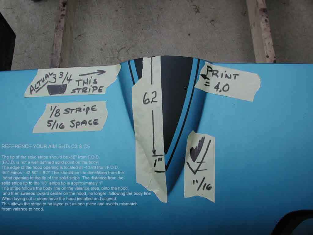

    Who makes the best stencil for the BB stinger on a 67? I have bought one years ago and it was sent to me flat and not rolled up. The ones I have ordered lately have been rolled up in a box. Any suggestions on who has the one sent flat or a real good one?

    I think you will have a better result taping it off yourself (or your painter).

            Hey Joel, Glad someone is using my "stinger" photos.....
            You forgot to tell Jeremy that he'll also save about $100.

              • Joel Falk
                Re: 67 stinger
                Are those yours Steve? I copied them so long ago I do not recall the source, but thanks so much! (I tend to save any picture I think is good.) These pics of yours are the very best visual description I have seen of the layout and dimensions. A picture is worth 1000 words!
