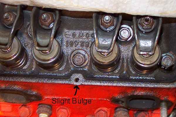

                  • Pat #25912
                    Is this the bulge...
                    you are talking about? This one protrudes about 1/16".
                    • Pat #25912
                      • Joe C.
                        • August 31, 1999
                        • 4598
                        Is That "C 17 5"?
                        That looks like the "flat". The protrusion, which shows up on a pair of '63 heads that I have, is much more pronounced. As was stated earlier, they protrude about 3/16", and their radii are also about 3/16", so just about a full semicircle protrudes.
                        My April 1965 heads look like yours ("flat").

                          • Pat #25912
                            Joe, it is C 17 6 *NM*
                            • Pat #25912
