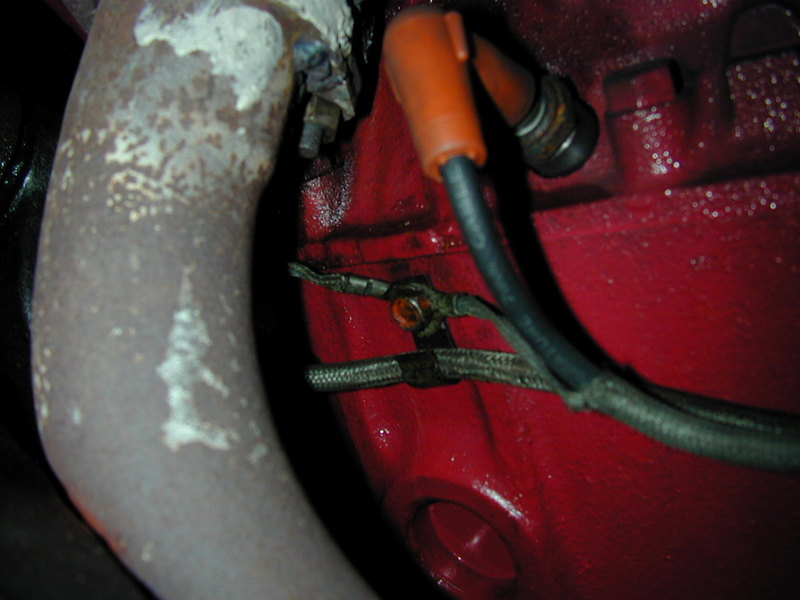

                      • Dave Suesz
                        #26
                        1955 braided ignition wire routing
                        The rear clip, which holds three wires and two grond leads.

                          • Dave Suesz
                            #28
                            1955 braided ignition wire routing .2
                            This is the front wire clip, which holds one wire and two terminals.

                              • Dave Suesz
                                #30
                                1955 braided ignition wire routing .3
                                another view, showing the offset.
