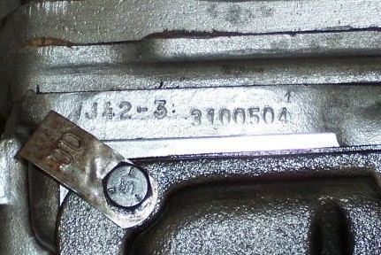

    does anyone know what the correct size of the stamps for serial #'s and build dates on a borg warner t 10 ......thanks...... I think the serial #'s are 5/32" and the build dates are 3/16 " just like the stamp on the eng pad ...any pictures of trans stamps on transmission would help .

    Nancy, I've not measured the font, but here is a picture that should help.
    Note the QQ tag. I believe this is a 1962 carryover prior to the change to the tag with the numbers.
    Harry
