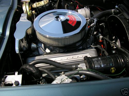

    Can anyone post a picture of the green ground wire connection to the compressor? Thanks

    Here's our 67. I've pulled it out from under the fender where it belongs. As you can see it gets attached at the Comp.Al W.

        Sorry I tried! Ours bolts to the Comp. lower outboard bolt. Al W.

            Here's the photo

                My photo is the same as Mike Ward's. Dale

                    To be picky, the green wire supplies power to the compressor clutch and a black wire provides ground from the clutch to the compressor mount.

                        Green wire not in a black tape bundle? *NM*

                            Sorry! Of course. Al W.
