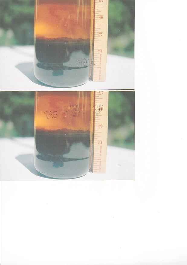

                      • Gary Bishop
                        #26
                        A photo of Sludge.
                        Here is a photo of the sludge.
                        • Gary Bishop
                          #27
                          A photo of Sludge.
                          • Mike McKown
                            #28
                            Re: A photo of Sludge.
                            My systems do not have signs of that in them. Aside from the obvious separation of large quantities of each type fluid, that looks like what you'd find in a Dot 3 system.
                            Looks like somebody just added one type fluid to the other to top off. You can't do that or you'll get the results you displayed. That looks like a large amount of water in your sample.
                            • Mike McKown
                              #29
                                • 15601
                                #30
                                I have cans of DOT5 labeled as a STP product. The directions on the can direct one to use the DOT5 fluid to flush out the glycol fluid. The SAE paper I referenced earlier showed the results of using this method of installing DOT5, the black sludge, and specifically recommended against using this method.
