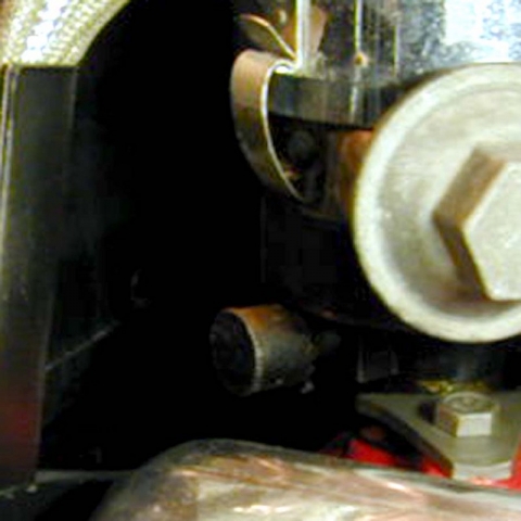

            Ok, more confusion. The 0984 I bought has no ID band, but has: short side oiler(no pipe), tach drive, single point, vac adv, but no cam wick(missing?). The vac advance is MS 163 16. But since the vac advance is replaceable it was likely changed? What's that vac adv application if you know?
            My 0984 pics:
            Rich

              Re: Distributors: 55-82 Reference Guide & Help Ple
              Looks right, you can see the slot where the wick for the points lubricator goes, finding them missing is not unusual, and the function they provide is limited. The original vacuum advance would have been a 201, but the 163 is actually a better unit. For Restoration purposes, 201 repro's are available, but if just for driving, I'd keep the 163. It is "all in" at less vacuum, and therefore more stable with today's gas.

                  What's also interesting is the picture of the "stovepipe" oiler on the 0985 pictured. I thought it was like my 0984, just the side mounted GITS cap with no pipe. I guess I'll have to park on a hill sideways to oil mine!

                        1) You refer here to a "894" distributor. I assume you mean "984" since there was no Corvette distributor of GM #1110894;
                        2) The style of cast iron distributor seen here was used ONLY for 1962-74 non-FI Corvettes and a few 67-69 Camaros. So, the distributor has to be a 1962-74 distributor; it CANNOT be a 1958;
                        3) The fact that the housing has no hole at the the rear of the tach cross gear cavity means that it's a distributor that was manufactured prior to ABOUT 1970 or 71;
                        4) As far as I know, the "stove-pipe" oiler was used only for the 1962 model year. However, it would not surprise me if it was found on some distributors for a year or two after that time;
                        5) As far as these 62-74 Corvette tach drive, NON-TI distributors go, most of the differences are internal to the distributor and involve the installed cam/weight base, auto cam, weights, and springs. External differences include vacuum advance provisions (the only 62-74 PRODUCTION distributor that lacked provisions for a vacuum advance was 1962 340 hp), the installed vacuum advance control, "hole-or-no hole" (as described above), "stove-pipe oiler" (generally, only 1962 had this as described above), and the distributor ID band (which is easily removed and changed);
                        6) For the most part, any 62-74 PRODUCTION distributor can be reconfigured to match ANY of the non-FI Corvette distributor part numbers used from 1962-74. The ID band can be changed to match the distributor configuration defined by a particular part number and, presto, one has that distributor.
                          >>>>So the band was definitely replaced, makes sense now.
                          >>>>What was the hole used for?
                          >>>>Should my 0984 have a stovepipe? Mine does not, just the GITS cap oiler. All 0984s I've seen are this way.
                          >>>>Understood.
                          >>>>So my post which shows my 0984 looks ok to you also? I'm still confused about the stovepipes on 62 only.
                          Rich
                            • 43221
                            Rich-----
                            First, let me clarify my description of "stove pipe oiler". By this, I mean just the VERY short oiler tube with spring-loaded cap (which looks like the rain covering for some stove pipes). I do NOT mean the long "L" shaped oiler as used on some bowl type distributors. That long style oiler was NEVER used on a 62-74 style Corvette distributor.
                            The hole in the end of the cross gear cavity was added to facilitate installation of a nylon button to control thrust on the tach cross gear. This little improvement was one of the most important ever made to these tach drive distributors. It IMMENSELY improves the longevity of the tach drive gears.
