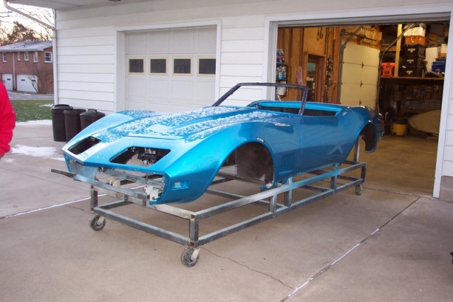

                  Yes 74's and 73's had the rubber mounts but the location was the same as a 72 body. I have a 72 body on my metal solid dolly now and it was built for a 73. I think that the problem is the rubber mounts are thicker than the solid pucks used up till 72 so a 69 body on a 74 frame would set lower if you used the pucks. I have a 71 and a 74 frame so I will do some checking. This picture is when a 73 was on the dolly.

                      I measured a 71 and a 74 frame and the #2 and #3 body mounts were the same heigth above the frame rail. The 72 pucks were 3/8" thick and the rubber mounts are 1" thick on a new mount. If the bodies were not changed 73 and up set just a little higher above the frame depending how much the rubber compressed.
