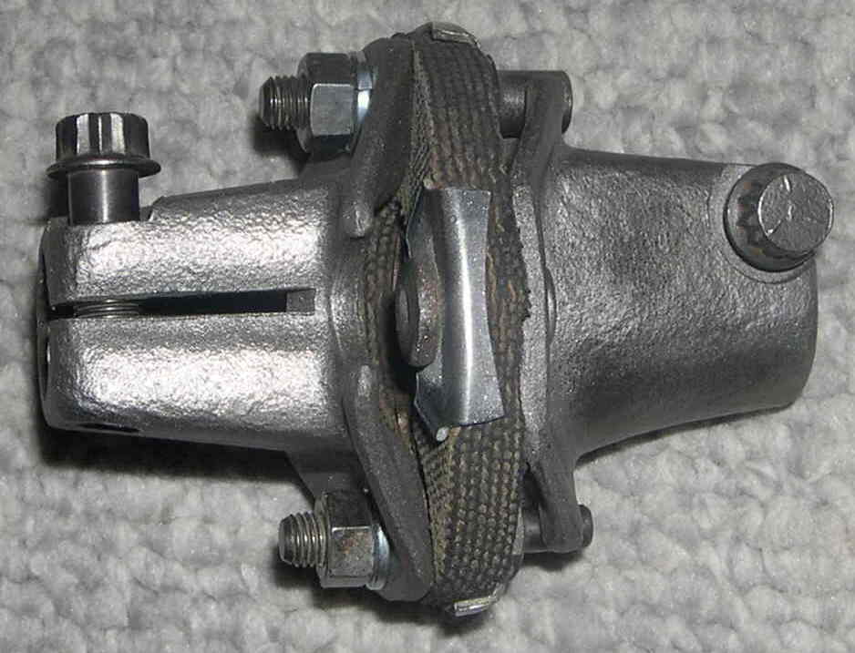

        Here is a photo of my original restored 67 rag joint.
        There are 2 rivets and 2 bolts with the black/grey fabric between.
        The "rubber/plastic" boots cover the rivet studs.
        I have not seen a riveted rag joint reproduced nor the stud covers. Typical reproduced joints are 4 bolts.

              Just out of curiosity, should a 69 also have those rubber caps on the rivets?
              Steve, are those the original ones or did you have to find something that "would work"? They look like large well nuts with the threaded portion removed....

                Greg-----
                No caps on the rivets that I am aware of. That's for any year. I can only guess that these are some sort of aftermarket thing. I've not seen them on a GM joint.
