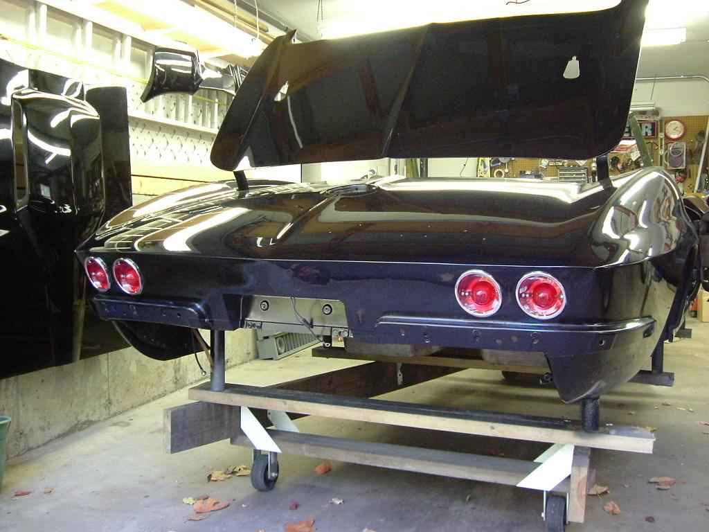

                          • Mark S. Lovejoy
                            Re: Lacquer primer question...
                            I shot DP90 over lacquer primer. DP90 on a Saturday, PPG lacquer topcoat on Sunday. I'm very pleased with the result.
                            Mark

                            • John D.
                              • December 1, 1979
                              • 5507
                              Mark, AS always you do reallly nice work. Pleased to see you went the lacquer route. My 63 has some really old ermine PPG lacquer on it and it shines so much the guys think it's clear coat. I used some GM Hand Glaze that I had stashed away for an eon and boy does it shine. John
