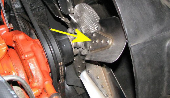

          • Romeo Sinopoli
            UPDATE
            Thanks Guys, I followed along in the AIM and see the same PN mentioned above.
            About my vette, I've had it 4 yrs and was told I should get it judged after correcting the obvious. I'll spend the winter searching for correct parts..fan, alternator, etc. I'm in Toronto, so only a few more weeks of driving. I'm attaching a current picture of my setup for you experts to critique. I'm buy the fan/clutch in the prevoius picture because the cost is only $22, who knows sounds like a good deal if it turns out to be correct. I'll post more info. once I have it. My fan now is chrome, the previous guy liked to dress it up.
            • Romeo Sinopoli
              Re: UPDATE *NM*
                • 11643
                Re: UPDATE
                Romeo,
                I note the fan has a "W" on it.
                It may be the original fan, but he had it chromed. Any chance you found any other numbers on it?
                Also, look closely at the mounting edge of the fan clutch, where it mounts to the water pump pulley. Is there a date stamped on the edge? The 1970 I'm working on right now has 5 5 70 stamped on the edge in plain sight, and the clutch appears exactly like the one you show.
                Let us know what you find.
                Patrick
                  • 43221
                  Re: UPDATE
                  Romeo-----
                  From what I can see of it the waterpump looks like a GM #3991399 casting. That means that the waterpump pulley is almost certainly a GM #3991423. That, in turn, means that the fan clutch should be a GM #3991426 and the fan a GM #3991420.
                  From what I can see of them, the fan clutch and fan on the car now are the above-referenced pieces with the exception of the finish on the fan.
