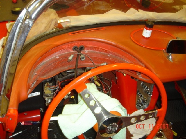

            Yes, easiest method that I've found is to remove the entire cluster. Can't get the speedo & Tach out while the cluster is installed in the dash... unless you are real little!
            You should remove the steering column support screws but the column may or may not move too much. Just enough to give you some wiggle room. Don't forget to cover the column with a towel to avoid paint scratches.
            Took about an hour and a half, give or take. Here is what it will look like when done...
