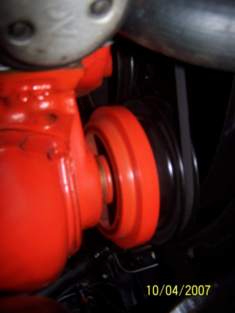

                      I'm not very good at sending pictures but here is a valiant attempt! It may be too big, but here goes.....
                      • Brad K.
                        • August 31, 1990
                        • 414
                        Re: 57, 58 & 59-61 HP balancers are different
                        Here another attempt.....It is too big and I've got to figure out how to reduce it. It's also fuzzy but you can kinda tell what it looks like. I WILL get better at sending photos!

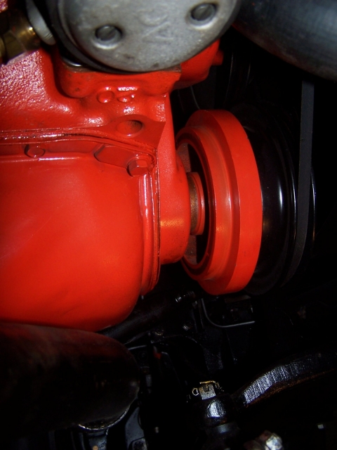

                        • Brad K.
                          • August 31, 1990
                          • 414
                          This one's is clearer....still haven't figured out how to shrink it! Anyone have suggestions?
                          [/IMG]

                            Super!
                            Thanks Brad!
                            So the stepped portion is one piece with the rubber ring seperating a spoked center piece. I wonder if the spoked center piece is common to the 283 chevy balancer and the vette balancer in your photo?
                            Joe
                              Joe,
                              I wasn't clear on the construction of my center piece. It is solid....with out spokes. I agree that the JG is incorrect, showing a spoked hub.
