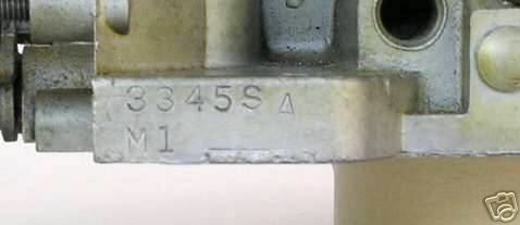

            • Verne Frantz
              Font
              An original AFB for your car would have a font like this one. Note that this carb was manufacturered Dec. '61 (M1) with no rev.
              • Keith M.
                • November 1, 1976
                • 205
                Re: Font
                Verne, your photo is what the judging manual says.Now are all these carbs I see with double numerical stampings serive replacements? Thanks
