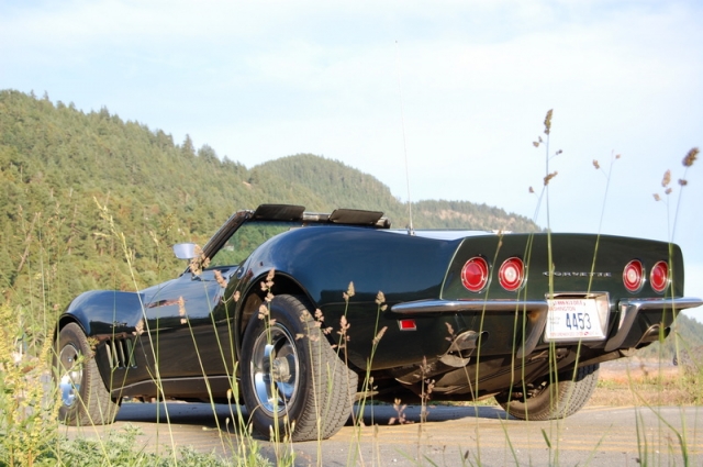

    I've no answer to your question but I do want to complement on the attached picture!!! VERY NICE!!!
