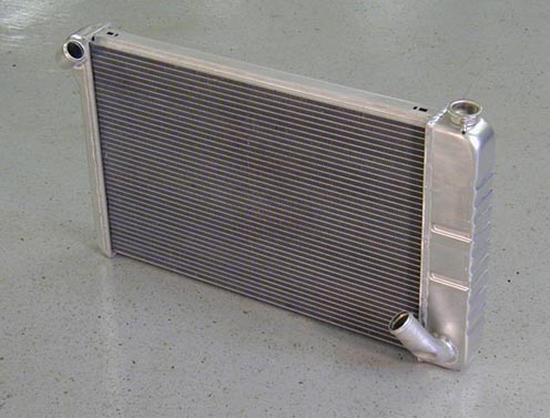

    Does your car have a cooper/brass radiator in it?
    If so, the lower outlet has a built-in flat spot so that it won't hit the front stabilizer bar.
    I would suggest that you actually might not have tightened the hose enough at this point. I often find that with a heat cycle or two I need to re-tighten my hose clamps after installing a new hose.
    See the picture below (borrowed from DeWitt's) that shows the kink in the lower outlet.
    Patrick

      Whew, that makes me feel a little better since that looks like the same dimple that I am feeling on my radiator. I am concerned about the leaking though since it's not just a little drip; I have a puddle under the car when I stop and turn the engine off.
      Should I drain the coolant and put some sort of sealer on the flange or sand the flange for better sealing? Did I make a mistake when I sprayed the flange with WD-40 so I could get the hose to slip all the way onto the radiator?
