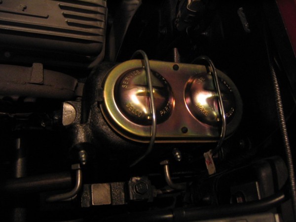

                      Thanks for all the replies. Here's a pic of the new master cylinder in place.
