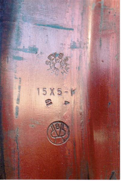

          What are the dates on your wheels?
          Here is a shot of the wheel date on my April built 61.
