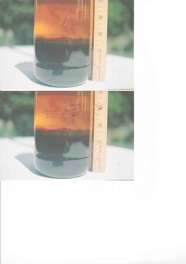

      I have been using DOT 5 in my `62 since `95. Just after the Steamboat Springs National. Up to then any all reports I read said I could flush the DOT 3 well and put in DOT 5.
      I did, and also changed the rubber hoses. After a year I flushed the DOT 5 with more DOT 5. I let the sediment settle for a week or two and there was a separation. Black DOT 3 on the bottom. DOT 5 on the top.
      Since then I have flushed the system with DOT 5 a couple of times and get very little separation.

              Due to the lack of miscibility between DOT 5 (silicone) and DOT 3/4, I highly recommend AGAINST attempting to change from one to the other by "flushing" because the lack of miscibility will prevent all the old fluid from being expelled.
              A good time to change to DOT 5 is during a complete brake system overhaul, but all pipes must be thoroughly flushed with denatured alcohol and dried, new hosed should be similarly cleaned and all hydraulic components assembled with DOT 5. You don't want one molecule of conventional fluid left in the system.
