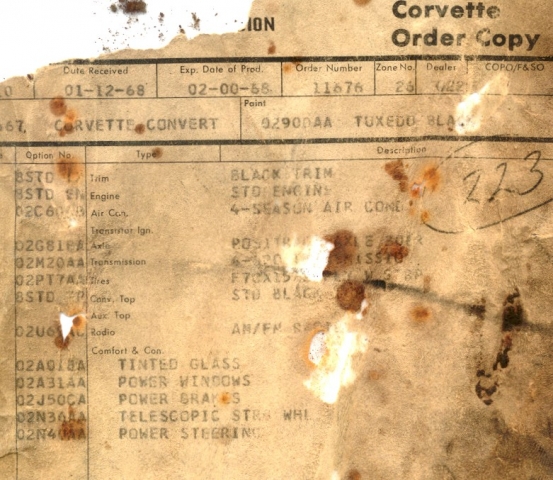

          Re: Tank sheet question
          Tom,
          On my '68's build sheet, the standard engine is listed. I'm not sure how it was done in 1970.
          Here's a look.
          Anthony

                            • Anthony S.
                              • April 3, 2008
                              • 183
                              Greg,
                              My VIN sequence is 9736, which minus the "223" on my build sheet is 13 off of the 500 mark.
                              As per Drew Papsun, this is within normal limits. He has a large registry of VIN #'s vs. Build sheet #'s. He is definitely the guy to ask on this issue.
