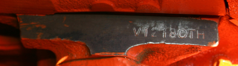

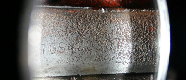

    Hello.
    I was given this site from quite a few people that highly recommended it for helping me with my problem. I recently acquired a 1970 L-46 Corvette and had some questions pertaining to the placement of the VIN stamp. This vehicle is the first instance that I've come across where both the Partial VIN and Date/Engine codes were not stamped on the plate at the front of the block. I have my Date/Engine code (V1218CTH)stamped into the right hand side of the block plate, but nothing is stamped onto the left hand side.
    And I found the Partial VIN stamped into the oil filter area.

    So at this point, I'm looking to confirm that this is infact something that happened from the factory for the Corvettes so that I don't have to worry about this not being the correct engine for this car. The block stamp is located at the read of the engine where the tranny mounts to it and that is 3970010.
    Any help on this subject would be greatly appreciated.

    This anomaly was found on early 1970 Corvettes, yours being the second that I have seen in over 22 years of looking at these cars. According to the information we have this style of stamping occurred during the first 3 to 5 days of 1970 production

      Does anyone have any reason as to why this was done during that time frame?
        • 15595
        Re: ID Stamp Placement on my 70 Vette
        No one that has come forward can explain why this happened, but it is well documented. Enjoy your 1970.
