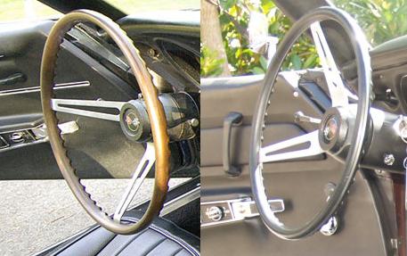

    Hi guys
    for a 69 vette which steering wheel would be right ?
    left or right ?
    thanks
    Frank

    Frank,
    Mine looked like the one on the right.

      Re: 69 steering wheel (right or wrong ?)
      mine look like the one on the left ... but i dont know if its original from gm factory ... or dealer install or after market.
        The one on the left is a 1968 wheel.
          the left image is actually a 68 vette ...but the steering is identical as my early 69 vette
            Frank------
            All 1969's originally used the steering wheel shown on the right in your photos. I really doubt that there were any exceptions, even for early cars. The 1968 and 1969 steering columns were completely different. 1968 used a steering column very similar to 1967. For 1969, the column changed and the same basic design was used through 1976.
              Part of the reason that a 68 steering wheel would not have seen use on a 69 was that the steering wheel was one of the many 68 mistakes. Anyone of more that average size had a hard time getting into the car. The 69 wheel was one inch smaller in diameter.
