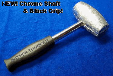

      As for "one posting said the wheel should NEVER be on the ground while tightening the spinner" - I see this thought posted from time to time, and have to wonder if whomever posts that even OWNS, much less have ever installed, a KO - for one thing, just how would tighten the spinners on the front wheels, with nothing to stop them from spinning if off of the ground? As for me, I tighten the spinners (as described above) while the wheel is in the air by hand, and give them one love tap or two, then bring the car down and let the big lead hammer do its work with the wheel on the ground. I myself use a 6# lead hammer of the "****** Thumper" variety shown below. I am also quite shy about allowing anyone else to install my wheels - I don't think today's tire jockeys are at all familar with the process required.
