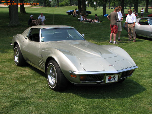

              Patrick you little stinker! You did not say HI. I see you got my NCRS plate in the photo.That paint is a killer.The gas tank did not leak the lines were cracked.I'm telling you guys I was turning this car into a driver.Till #3396 stept in.

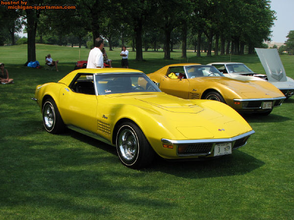

                          I spent WAY too much time drooling over that yellow LT-1 car near yours. I think (?) that based on judging results it belongs to a Mecum. I would have given him cash on the spot for that car and cancelled my 2008 order. That was a NICE car that would have been a great twin to my own 72.

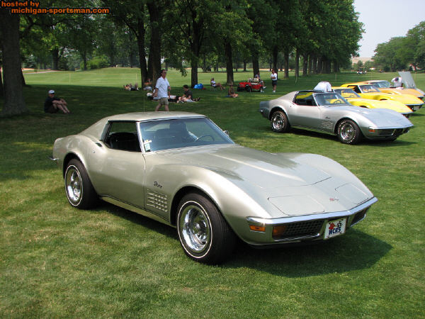

                            Re: Spy photo
                            I said crap they got a photo of my car.But then at a closer look you got Freds car.We laughed at each other and said dont break your key off in my car. That is SteelCity Gray in the photo.Mine is next to his.Denny72

                              As I recall, the silver one in my picture had your name on it in the window. So, my "assumption" was that it was your car. Also note the Survivor sticker on the passenger's side which is not present in the car towards the rear (as far as I can tell or recall).
                              Is yours the 72 towards the front of the picture with whitewalls and the NCRS plate, or 71 in the rear of the picture with white letter tires and no NCRS plate? The one in front appears to me Pewter Silver like yours and not Steel Cities Gray.
