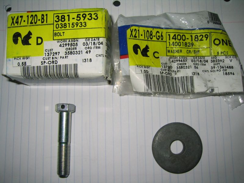

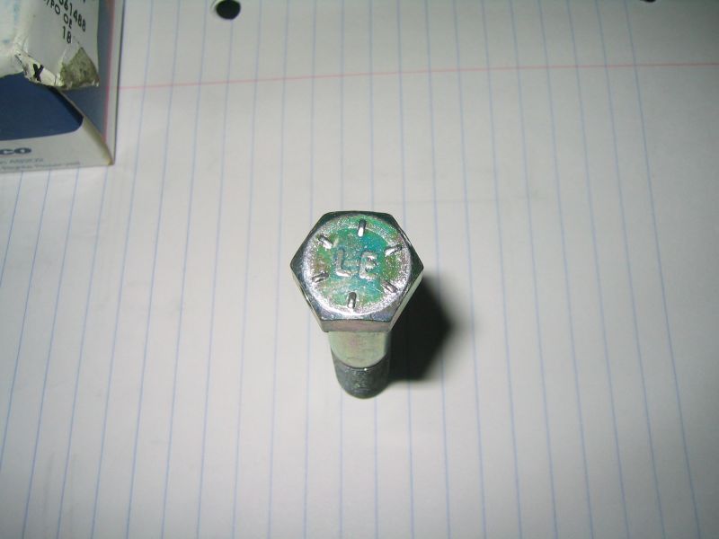

                      • Brian Monticello
                        Re: Correct 1964 crank pulley bolt?
                        Here's what they look like from GM.... part #3815933
                        brian

                          Joe, THe last time a friend of mine purchased the bolts the logo was and is LE and they were blackened. I think that we all make too big a fuss over bolts as far as which were black and which were shiney. Not referring to you but just our judging process in general. I know for a fact that Rochester Products was not that fussy with the FI's. Thanks, John
                          • John D.
                            • December 1, 1979
                            • 5507
                            Brian, Thanks for the nice pic of the LE bolt. I see you and JL agree that the replacement bolt was shiney. The original TR was zincad also. John
