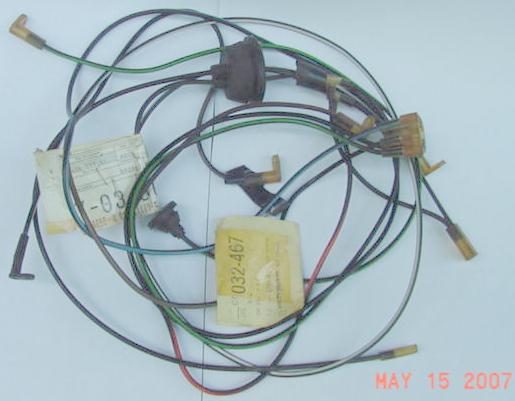

    My 77 all original car has a broken vacuum line going to the hot water shut-off valve. It is a thin, all white hose, with a special clear plastic nipple on the end with a capture loop, not a black vacuum-type hose. I ordered a kit from one of the reputable suppliers to get the one hose from it and when it arrived it was a black vacuum-type hose with a white tracer. Not the same. Anyone have any ideas about what and where? I'm going to have this thing flight-judged and I want it to be right.

      Thanks for the background Geoffrey and thanks for taking the time to answer. Sometimes its difficult to get this kind of info on the "smog sharks".
      So, I think where all of this is going is that unless I can pull this hose from another 77-8? car I'm stuck with the replacement? NOS is probably nonexistant or at least very rare.

            Re: 77 C3 hot water valve vacuum line
            Mike,
            Take the new black plastic hose and clean it to remove any oil and paint it white with semi gloss Krylon paint. It will age to a pale white. Route the hose so it will not be exposed to the high heat of the exhaust manifold.
