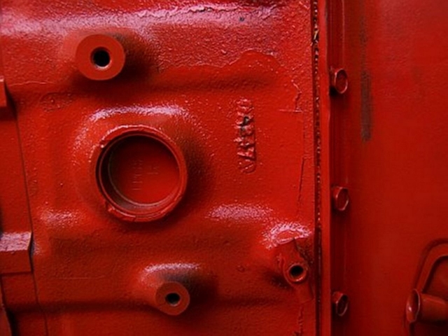

    Trying again to post the photo. Take a look at this A 24 7 date on a 427/390 HP. Looks a little tight between teh numerals. Maybe not. What is your take. Does anyone have a photo of a January 67 casting date I can look at.

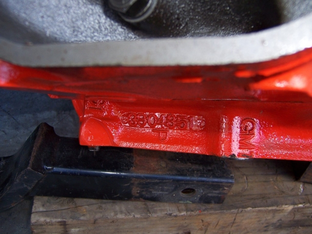

    Here is the casting #

      Bigger casting date?
      This may help?
        Re: Bigger casting date?
        60's casting date tags for the patterns weren't "precision parts"; they were individual brass characters, hand-soldered to the base tag, with occasional variations. Hard to make any judgment with paint on it.
