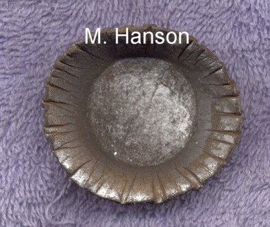

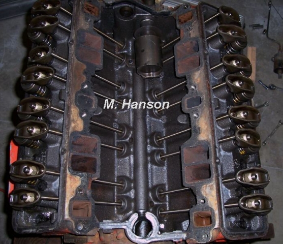

                Anyway, I recently posted some pictures of original engines and parts with obvious silver paint. To refresh memories:
                Here is a picture of an original factory plug used to block the oil fill tube hole prior to installation of the chrome tube. Note the overspray color:
                In this picture, note the silver on the small area of the heads that would normally reside between the intake and the valve covers. It is especially noticeable between the water jackets and the intake ports at the rear of the engine (the "bottom" of the picture):
                I hope that helps.
