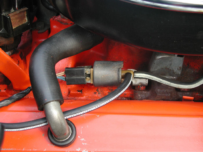

              Take a look at this picture. Your 70 should be set up in a similar manner. The "one port" is the one that needs a foam filter and is open to the air. The "two port" shaped like a T or L is the one you need to use for the distributor vacuum.

                  Patrick - this setup sure seems to make more sense than the other way around, but every diagram/picture I've seen (Dr. Rebuild, 70 service manual, article in the restorer) shows the T or L pointing towards the rear. Are you sure is should be configured this way? Thanks, Patrick Moresi #45881

                      Patrick,
                      Mine is a 72, and I can guarantee you that it functions well in this configuration. If possible, I'd like to see a picture of your 1970 solenoid (although I believe I have a couple of them). I note that in the DR catalog, yours and mine do differ. The pictures in Dobbins' book of a 1970 also match the DR catalog.
                      To further diagnose yours, you need to know 1) is vacuum being provided to the solenoid from the Front or the Rear of the carb, and 2) when the solenoid is on (or off - either answer will help) which two ports of the valve are "open." This can be discerned by just blowing into one of them with a hose. If air goes through the solenoid, which two ports is it travelling through.
                      Once you confirm the above by testing it yourself, then we can see what's really happening.
                      Patrick

                        In 70, electric connector points forward, thats the difference

                          The TCS solenoid is essentially the same for '70 and '72 but there's a PN change and the orientation of the valve with respect to the integral mounting bracket flips between the two...

                              On mine, when the solenoid is energized it pulls away from the L (or T) shaped fitting, and allows vacuum to "pass" thereby enacting the vacuum advance on the distributor in 4th gear (or when overheating). See my picture above for clarification of direction, if needed. Apparently a 70 must default towards the L-shaped end when in gears 1 through 3, and move towards the L-shaped end when in 4th.
                              Does anyone happen to know if the solenoid is actually turned ON or OFF in 4th gear (i.e. energized or not)? If it is energized in 4th gear, and that causes the plunger to move toward the L, then it has the opposite winding and/or magnetic property from all the ones I've otherwise tested. I suspect that in real life 4th gear DE-energizes the solenoid but I'd be very interested to know for sure.
