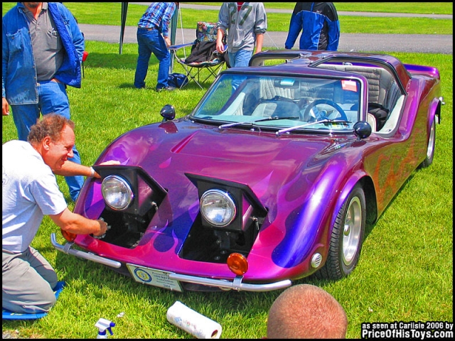

                    Re: Could my trim tag be wrong?
                    Jim,
                    Remember, you can paint it purple bass boat metalflake and still get a Top Flight. So, what you do with paint will not disqualify you from having it judged. You just need to make informed decisions as to where you may lose points in the judging process.
                    Patrick
                    • Jim P.
                      • August 31, 2003
                      • 89
                      I think I'll throw in the towel now. I could never compete against that!
                        • 11643
                        LOL!
                        I know it's not a Corvette, but I couldn't find that great of an example of "bass boat metalflake purple" on a Corvette. There's one in a garage near me, but I don't have any pictures.
                        You get the point, though.
                        Patrick
