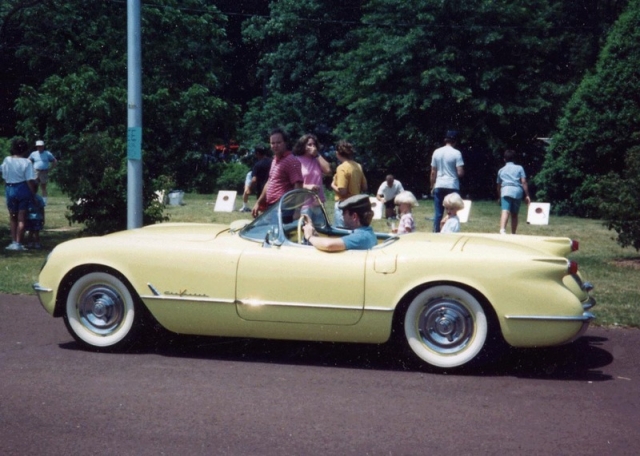

                  Well, I will
                  continue to call my car a roadster.

                        Re: Well, I will
                        Dave-----
                        Well, so would I. Like I say, 1953-55 Corvettes ARE roadsters; they're the ONLY Corvettes that are.
