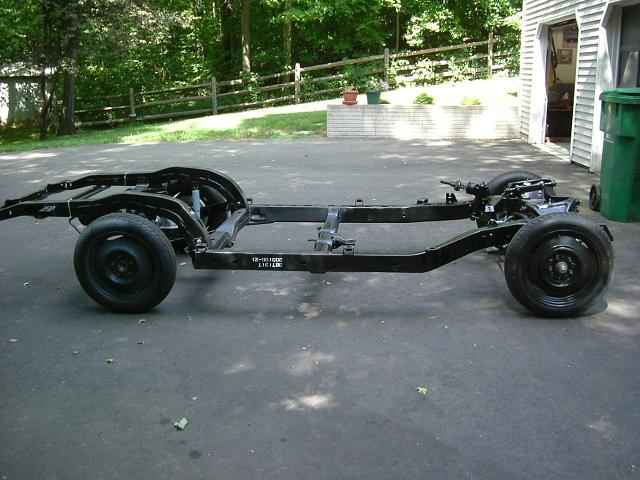

    Are there other GM wheels/rims that will fit a '65 just for rolling the car in and out during restoration ?
    Marty
  • GL Anderson
    Re: Other '65 Wheels ?
    There must be hundreds of different 15" wheels that will physically fit. Most any Chevy and BOP wheels shared the 5 lug 4 3/4" bolt patterns. Just need to make sure they aren't too wide 6" or so and will clear the brake calipers. I would think mid 60s to late 80s with the above dimensions will give you many dozens of choices. Any junk yard will have a ton of them and the price should be cheap. GL
    • Jerry P.
      • September 30, 1989
      • 85
      go to a junk yard and get 4 small spare tires works great
      • Mark S. Lovejoy
        I use compact spare tires for restoration work. Pump them up to 70 psi, they roll much easier than any conventional tire.
