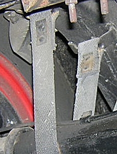

            Interesting. The 53-55 AIM with its cute cartoon drawings doesn't even have a drawing or picture of the chassis in it! While the 53-55 JG just says rivets but not pop-rivets, but it doesn't specify their direction.
            BTW the photo I posted was of my 54 rebound straps which I beleive are originals
