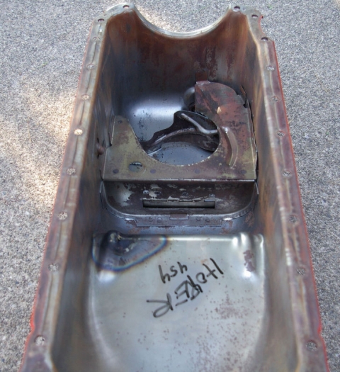

        I have a 71 (Sept 70 production) LS5, SN 1632. The pic is of the oil pan, that as far as I can tell by talking to the previous owners, is original to the car. I need to put in 7 quarts to get to the full mark on the dip stick when changing the filter. The dip stick is the correct one and seated fully in the pan.
        I had a 71 SS454 Chevelle that had a different pan without the baffles and trap door. That car did take the 5 + 1 quarts. I was very suprised when I pulled the pan last summer and saw the internal baffles.
        Is this the correct pan for the car?

          The oil pan pictured appears to be a correct Corvette big block oil pan.
          As far as the capacity is concerned. I can tell you that 5 quarts without filter change and 6 quarts with filter change is the capacity of all 1965-74 Corvette oil pans. This is the capacity specified by GM. It's also the observed capacity.
          Why yours is different I cannot explain with certainty. All I can figure, assuming that the pan is correct which it appears to be, is that the dipstick OR the dipstick tube are not correct.
