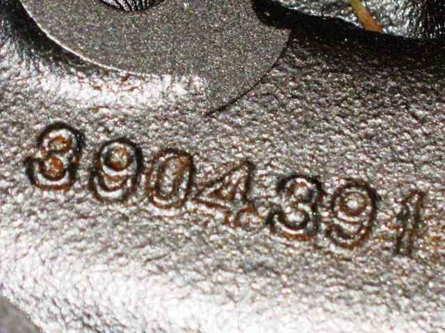

  • Mark #28455

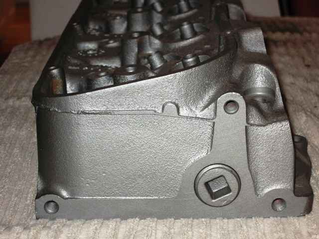

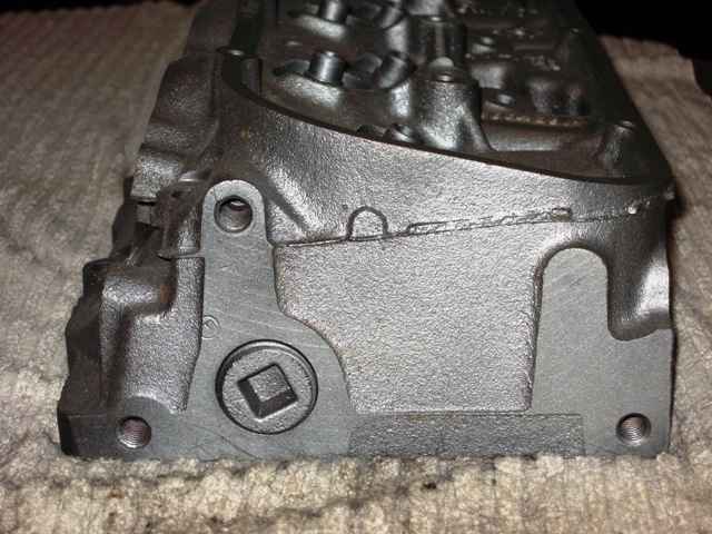

    obvious clues
    The heads in question must be closed chamber rectangle port heads. Although it is possible someone may have used a 1965 or 66 vintage head as a donor, it's not that likely given they cost big $$$ too. More likely would be an 840 head from 68-69 or a 1970 and newer 291(?) head. The 1968 and newer heads will have a 1/2" pipe thread hole over/beside one of the exhaust ports for the temp sender - the 1967 heads should not have this hole and boss. The 1970 and newer heads will have taper seat 5/8" hex spark plug hole machining whereas the 1969 and earlier use a 13/16" gasketed seat plug.

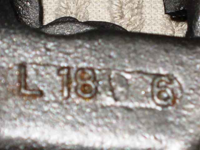

      In 1966, Were Heads ever cast on a SUNDAY?
      The casting date on the heads is a Sunday!
      I forgot to ad this part of his email....
      "I forgot to mention that L 18 6 was a Sunday, which is just another oddity that I cannot find on any head casting dates regardless of the number!
      I did not realize this until after the purchase."

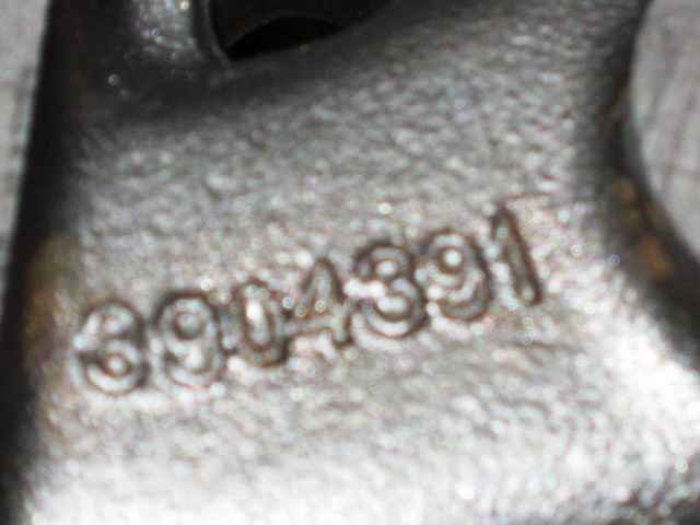

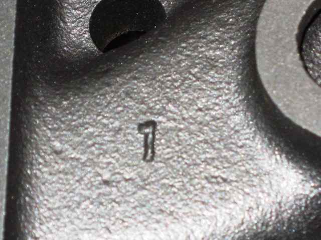

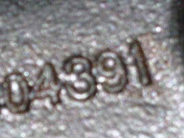

        Here are Jacobs pictures
        Front
        Back
        Top
        Top #2
        Bottom
        Bottom #2
        Date

          • William C.
            NCRS Past President
            • May 31, 1975
            • 6037
            Re: In 1966, Were Heads ever cast on a SUNDAY?
            Yes. on occasion the heads were cast on a sunday, I think you are missing the larger question here, regarding the size of the sparkplug holes and the presence or lack of the boss used on very late '67 and all later heads. If those are looking ok, the heads are very much more likely to be good.

              • William C.
                NCRS Past President
                • May 31, 1975
                • 6037
                The Boss is a real killer, the numbers in the casting dates were variable as a new impression was made for each pour. There is a lot on information on the casting process in the archives, and one of our members from the Saginaw area has samples taken from when he worked at the Saginaw grey iron foundry. The boss would be hard to hide, and did not show up until late in the 67 model year. As stated previously, starting in '68, the heads were all drilled and tapped on that boss, with a temp sensor going in one side of the engine and a plug in the threaded hole on the other side. The boss has been seen as early as May of '67 I believe, and it may be mentioned in the Judging Guide.
