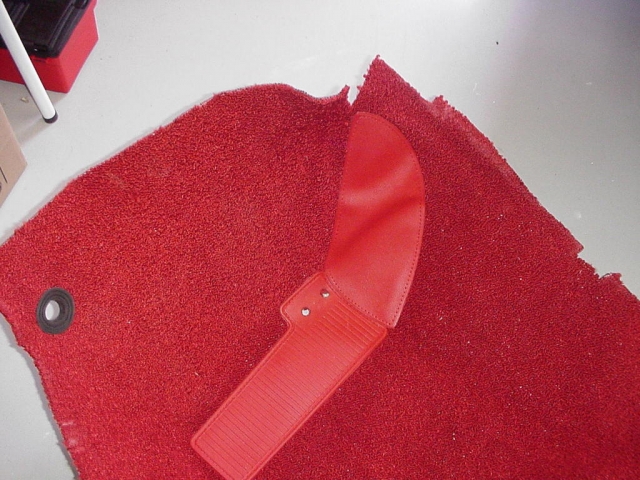

            Re: Al Knoch
            Ed,
            The problem I am having (66 conv) is a severe bulge at the top of the footwell in the area behind the gas pedal. As you can see from the photo, it seems to be pre molded in the carpet.
            Randy

              Re: Al Knoch
              I just encountered this same thing this weekend on my 67 (also red). I was able to heat gun it out and it was smooth when I glued it. But when I installed the accel. pedal last night it "tightened up" and came back.

                Re: Al Knoch
                I had a problem with too much carpet between the gas pedal pad and the location of the brite light switch and how it squared (or I should say didn't) I ended reinstalling the carpet from the front-back . I installed the gas pedal on the carpet where I knew it should go... used glue at that point. From there I stretch, pulled and cut the carpet until everything was covered. Lucky for me they furnished an unually large piece of carpet for the drivers side. It looks to me that you have a slightly different problem then I had. Different problem... same sloppy work.

                  Re: Al Knoch
                  There must have been a fit problem with the the original front carpet at the gas petal area because all original sets I have seen have a vertical cut about 4 inch long under the gas petal were the carpet is over lapped to make it lay flat.
